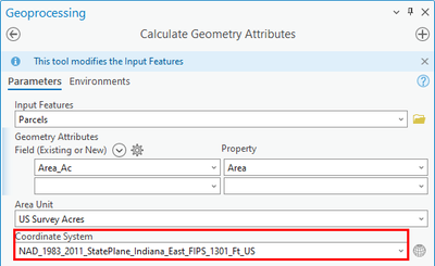

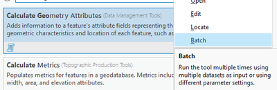

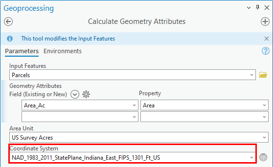

@ThomasHamill If I am following your use case, the Coordinate System is parameter/variable for Calculate Geometry Attributes. I tested running the tool in batch mode:

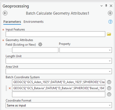

and use Coordinate System as batch parameter
and use different Coordinate Systems:
