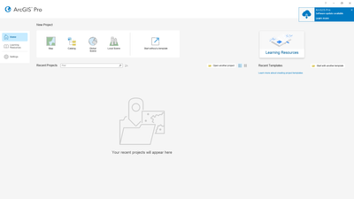

So, I did reinstall 3.4, and of course there are the same issues, and I have no DLL overrides. Compatibility set to Win10. Installed Edge in Win7 compatibility, and it seems this time around the Pro installer did not complain about WebView2, as I have tried this before to no avail. I started messing around on the blank sign in window again, and I managed to open up a github sign in page. Using a Windows-native instance as reference, I used tab selection to expand ArcGIS Login and enter my credentials. This approach did work. Although, I am not entirely sure why the page did not render, even when experimenting with many different graphics settings (including --disable-gpu).
Of course, this is a terrible workaround, but this at least means that other sections of ArcGIS Pro can be tested.
DevinGriffith
Attempted to apply the new patches. It looks like it updated to 3.4.1, but could not update to 3.4.2 for some reason . . .
Log attached.
