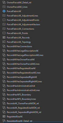

GDB before using Project, with 'incorrect' coordinate system:

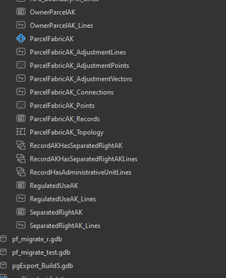

After using the Project tool to 'correct' the coordinate system:
Some of the relationship classes made it through, some did not - even the out of the box relationships inherently created by creating the Parcel Fabric geodatabase. The related tables also did not come through.
