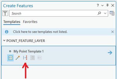

You performed an operation with a tool which is outside of the normal editing workflow.  The search you performed in step #4 incorrectly gave you access to a tool which is only supported on Point features.  You tried to use a Point feature tool on a Line feature and got a "Not supported for this geometry type", which is actually a good error.  You could log an ArcGIS Idea request to say that the Command Search should not give you access to a tool which is incompatible with the selected layer, but if you stay within the "typical editing workflows" this shouldn't be a problem.
1. create file geodatabase
2. create Line feature class in geodatabase (line with a PCS of NAD 1983 HARN StatePlane Hawaii 3 FIPS 5103 (US Feet);
3. draw line and save feature;
4. create Point feature class in geodatabase (line with a PCS of NAD 1983 HARN StatePlane Hawaii 3 FIPS 5103 (US Feet);
5. click Create button
6. In the Create Features pane, select your Point Feature Layer from the available templates.  The Template should have the Create Points Along Line toolThis tool will create new Point features. (Note: you could perform a command search for the tool, but I do not recommend that workflow for editing).
7. Per the Point tool instructions:  select a Line  (from another layer)
8. mess around with how many points are made along the selected line.
9. Click the Create button
10.  Your Point Feature Class should now have new Point features added.
I agree this is confusing and the tool instructions should be more concise.

KeithAdams1
You're exactly right! It didn't have a point layer to use. It worked perfectly, thank you very much!
