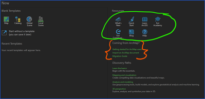

This is often missed by even seasoned ArcGIS Pro users, but on the welcome screen of ArcGIS Pro is this area off to the right:
Which has links to take you not only to esri training videos, but also has a convenient section just for migrating from ArcMap. If you haven't already, I would recommend spending some time going through this section.

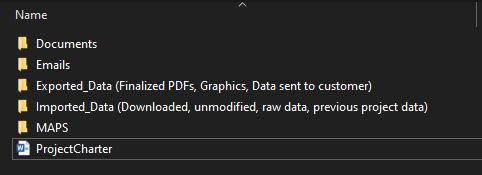

organizing the project folder is paramount.
1) set up a project folder
Set-up project folderSet-up project folder
 2) Here is a snapshot of how I organize my projects
Inside the project folderInside the project folder
 3) inside the MAPS folder, include subfolders for Layouts and Layers. the GDB for the project resides inside the  MAPS folder.
Good luck and have fun. AA
