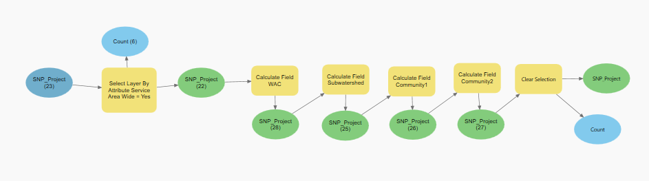

Does anyone know if  BUG-000176644 (The Calculate Field tool does not honor active selections and layer filters when using a SQL expression on file geodatabase data, resulting in calculations on all rows) is also occurring in Pro 3.3.5? I have a model builder that has a select by attribute step where it selects features where  field = Yes, and then on the selected features, there are 4 field calculate steps, changing the values to Null for all 4 fields. This model builder has been working fine with no issues for the past 2 years. Today, when I ran it, it ran the first field calculate correctly, but the the subsequent 3 field calculates changed all records in the layer to Null! Luckily, I had a backup of the data and can restore it, but I am very concerned it could happen with other model builders (I have about 20 I use to maintain this layer, with many select by attribute and field calculate steps. This is very concerning. Does any one have any insight?

It was only reported in 3.5 and is fixed in the first update (3.5.1 and in the upcoming 3.6)
BUG-000176644 for ArcGIS Pro
If no one noticed in previous versions, or reported it, then it could have existed.
There won't be any backporting of the fix, so the update path would be your only recourse.

Thanks, it seems somewhat sporadic. Unfortunately, we are stuck at 3.3.5 until we update our enterprise next year.

Not an answer to your question, but in Model Builder, I have had better luck with MakeFeatureLayer with SQL expression on it, then perform the calculations on the feature layer.  Otherwise, it seems I have to re-select before each operation.

Within the internals, BUG-000176644, is fixed at ArcGIS Pro 3.6, 3.5.1 and the ArcGIS Server 11.5 Calculate Field path is available here - ArcGIS Server 11.5 Calculate Field Patch
