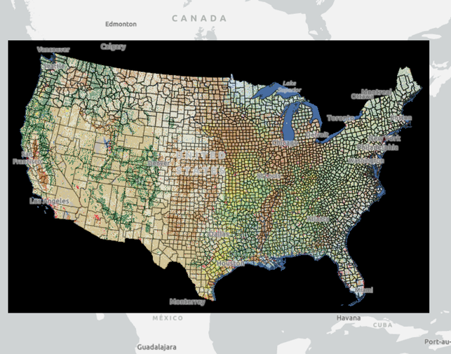

* Feature zone is a vector layer containing state boundaries of CONUS from TIGER/Line Shapefiles of Census Bureau
* The raster layer is the National LandCover Database (NLCD 2016) which is an .img file with 30mx30m land types over CONUS. (over 1 GB file size)
here is a picture of them
(projection for the map is NAD 1983 ContiguousUSA Albers.)

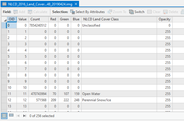

I am re-running with this change: Instead of using the Land Cover class below, I am using value as the Class Field! (I don't know what else is wrong). Would appreciate if you have any suggestions.
BabakJfard
And magically, it solved the problem (using 'Value' instead of 'NLCD Land Cover Class' in the picture above)!!
Not only the ranks make sense now (Iowa, Kansas, North Dakota,...), but the percentage is logical! (the total percentages of crop lands used to be below 1%).!!!
