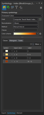

I am currently using ArcGIS Pro 3.1.1 and my symbology tab has disappeared.  I have opened new projects and tried new templates and the tab will not appear.  Any suggestions??

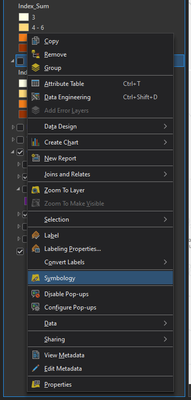

Hey @ShannonDale1, if you're looking for the Symbology pane, you can right click a layer in the table of contents pane and click Symbology.
The ribbon tab that controls a few other appearance toggles is now called Feature Layer, and it only appears with a (feature) layer selected.
If you R click the large Symbology button on that tab, you can add it to your quick access toolbar for easy access.

I did try this and it will not work. I have also uninstalled ArcPro and I still can't get any symbology options??

Which step did not work?
