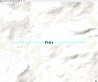

Is there a way to display labels in the same label class but different features as stacked? I have two polylines with identical geometry but have different values. Is there a way to display their labels as a stack instead of side by side?

I read through this post before creating this one. I tried using the stacking separators and it did stack each label individually but the two labels were still side by side. If I could upload a picture it would be easier to explain but I don't see an option for that.

MasonFord
I was able to post it to ArcGIS Online and share it.
https://vps.maps.arcgis.com/sharing/rest/content/items/b0f156276d2a4dd1ad49b9e58a5686f7/data
So I have two polylines in the same feature class with identical geometry. Both labels are part of the same label class. They both have different names (BFO 48RI & BFO 288RI). The labels are displayed side by side and I would like them stacked one on top of the other.  When I try to use stacking separators I end up with the BFO above the numbers but they are still side by side.

The result can be seen below.  One thing I had to change to make it work properly was on the Position tab in the Label Class pane, set the Label Buffer to 0%.  Then it stacks properly.

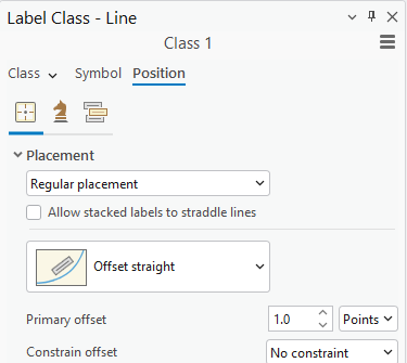

JesseWickizer
Allowing the line labels to be placed above or below the line could help with situations where there are only 2 overlapping features. Set the Constrain offset parameter to No constraint to allow this.
The result can look like this:
Keep in mind other labels and weighted features on the map will influence label positions so the labels aren't guaranteed to align nicely like this.
