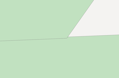

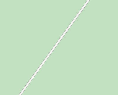

Hi all,
I've been running into a very frustrating issue with splitting large polygons (~60,000 acres). Seemingly at random, splitting a polygon results in gaps at the split or a subtle shifting of one or both of the split polygons. I've tried interactive splitting, and splitting by feature by creating a split line feature class. I've also tried adjusting the XY resolution and tolerance to 10x and 100x the default with no success. GCS is NAD 1983. Is this a bug or is there another solution I'm not finding?

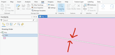

@RobertCao- Thanks for providing this. Do you know if that same issue could be impacting other topology-related operations? For example, I'm using the Align Edge tool with a map topology and a sliver gap is getting introduced where there is literally no possibility of one getting generated by the end-user (I've tested this is Pro 3.2.x and now 3.3.0 with the same effect). If you don't have additional info, I am likely going to submit this to Esri Support as an additional bug.
