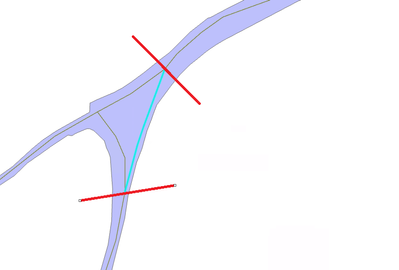

davidchamberlain2
Hi all,
Thanks for your interest. I want to split the polygon like this, the red lines being the splits. I have merged what was multiple polygons into one. There are thousands of line sections. The angle of the splits doesnt matter.
DanPatterson
MVP Esteemed Contributor
Split Line at Point (Data Management)—ArcGIS Pro | Documentation
will split lines at points, if you can create a point layer from the start/end point
Generate Transects Along Lines (Data Management)—ArcGIS Pro | Documentation
allows you to generate perpendicular lines along a polyline, but you would have to query the transect lines to only select those that are at the start and end points.  Those would be the ones to split the polygons with
At least something to look into

davidchamberlain2
Thanks for the suggestions all. In the end I used the subdivide polygons tool to split the entire layer into equal blocks, this with a spatial join to the line layer achieves the same result as splitting the polygons as I wanted to do originally just in a different way.
Thanks
Dave
