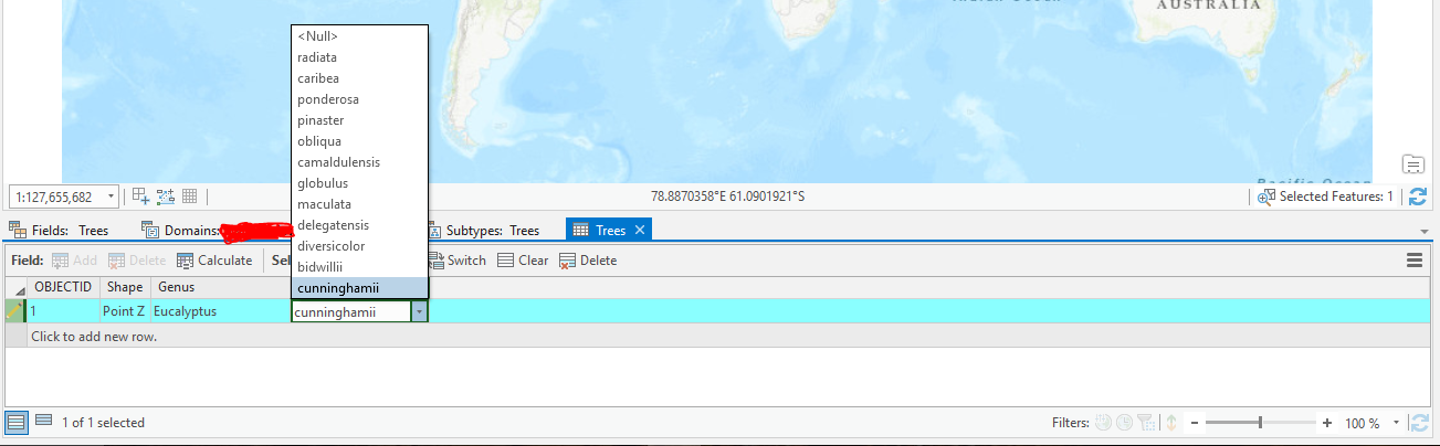

In ArcGIS Pro, let's say the first point feature I create is a Eucalyptus tree. The way this feature class is currently set up is that if I select the Species field's subtype coded value first with the value "radiata", it will auto-populate the preceding Genus field with the domain value of "Eucalyptus".
Is it possible to set up my data schema where if I select "Eucalyptus" in the Genus field first, I can select from a list of tree species values in the following Species field that are just specific to my "Eucalyptus" selection in the Genus field? For instance, in the screenshot below, I would rather have my list of values in the Species field to just show "obliqua", "camaldulensis," "globulus," "maculata," "delegatensis," and "diversicolor" if I indicate "Eucalyptus" in the Genus field first.

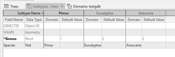

It is certainly possible using the same concepts of Domain and Subtypes. However, the below workflow will only help if the Genus field can be of data type short integer or long integer.
The Genus will be the Subtype field:

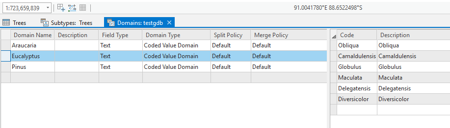

And you will need to create a separate Domain for each type of Genus, listing the Species as Codes. Example:
So the end result, when you try to edit, this is what you get:
