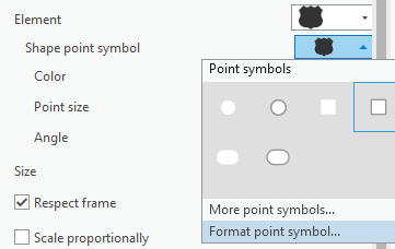

  2. On the elements pane, go to the symbol tab and then go to the Layers tab within thatAlfredBaldenweck_1-1748031644524.png
  3. Hit "Style" to change to the shield
  4. Now, hit the "Shape point symbol" drop down
  5. Select "Format point Symbol"
  6. Change the color to white and make the Outline more than 0 ptsAlfredBaldenweck_5-1748031802207.png
That's it. You'll have to adjust to get the right ratio, but you don't need to stack because the symbols never quite scale the way you'd hope.

  1. Insert your point

AvaFarouche
Aaaaaah thanks!!!!
I tried to format the point callout previously but every time I picked the shield the outline attribute would disappear. I missed that super basic step of going back to "Format point symbol" *after* I had picked the shield. Or something. Anyway, I missed that option.
Thanks!!!!
