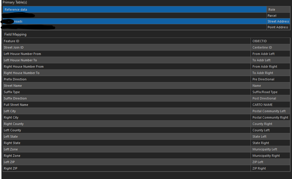

Hi @ShanaBritt , thanks for taking a look! I'm using a composite locator I've published to our unfederated server. I get the same result when I add just the one address locator with the road centerlines (from roads in WKID 2253) to my project. It says it is Release 3.5, compatibility release 3.0. Last built earlier this month.addrlocator.png

@ChelseaRozek Thanks for sharing the field mapping and coordinate system of the street centerline data used to build the locator. I see that you have a multirole locator in the screenshot, does it also include any alternate name tables that would be listed on the Alternate Name Tables tab in the locator properties?
If there are no alternate name tables that are part of the locator there is no need to map the Street Join ID locator role field. Including the FeatureID role field is only necessary when you have duplicate geometry in the primary reference data that have different attributes like different street names. When you do use the FeatureID field the field  you map to it should not contain unique IDs like the ObjectID field. Mapping the FeatureID field when you do not  have duplicate features with different attributes will increase the size of the locator, impact the time it takes the build the locator, and can affect the performance of the locator. See the following topics for more info:
https://pro.arcgis.com/en/pro-app/latest/help/data/geocoding/collapse-duplicate-features-in-the-data...
https://pro.arcgis.com/en/pro-app/latest/help/data/geocoding/locator-role-fields.htm
The Full Street Name field is also not necessary to map when building a locator for the USA as this field is not used for address matching.
