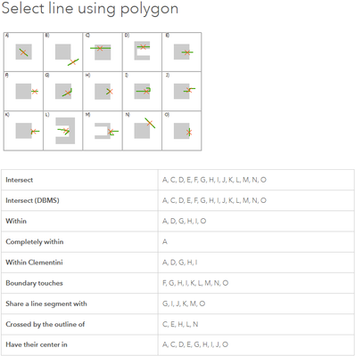

@FlightDeck Please review the details on each of the Relationship parameter options and you will get to the best results with a few iterations:
Select Layer By Location > Relationship
Example Graphics at: https://pro.arcgis.com/en/pro-app/latest/tool-reference/data-management/select-by-location-graphical...

@FlightDeck I am referring to the section below:
You can post screenshot examples of what you get vs expectation. It is possible the data is missing some attribution or the desired selection can't be performed using the out of the box tool.
