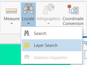

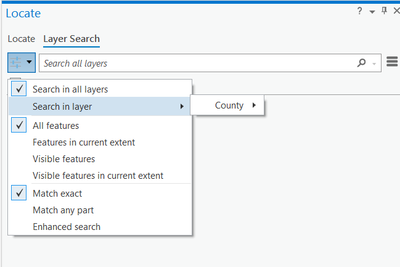

JayantaPoddar
MVP Alum
This one?
Under Map tab
Think Location
by Anonymous User
Not applicable
Yes, thank you. It's very different from the previous version I was used to so I missed it at first.
