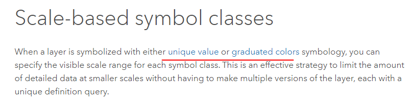

Scale-based symbol classes—ArcGIS Pro | Documentation still shows this as available only for unique value and graduated renderers:
I did find the following enhancement request which is "In Product Plan" but is not currently assigned to a release: [ENH-000123002: Allow users to set different symbology for the same layer at different map scales when using single symbol symbology.]  It might be good to submit this specifically on ArcGIS Ideas‌ to get a better gauge for demand (i.e. there is currently 1 customer interested in that enhancement + this thread...)
