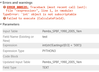

YusefSamari
Thanks! Unfortunately I'm still getting the same error message. Seems it still doesn't like the attempt to subscript an integer field, even with the string function.
I don't know why Field Type is showing as 'TEXT' there - the 'test' field I created is definitely an integer field.
DavidPike
MVP Notable Contributor
You have the brackets/parentheses messed up - must be str(!Eastings!)
YusefSamari
Woops! Thanks, that's working now.
