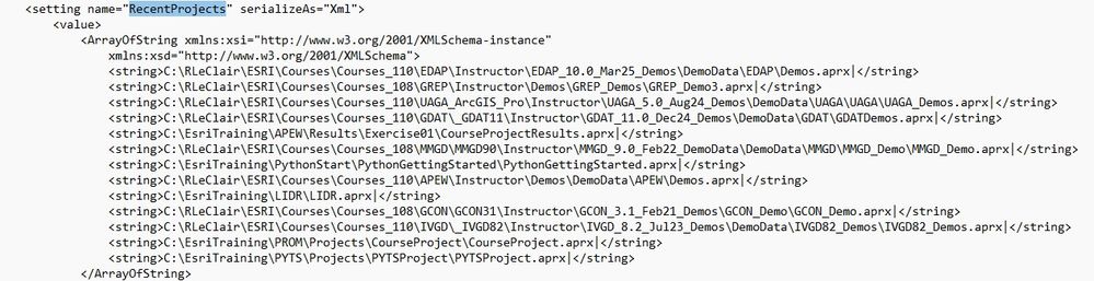

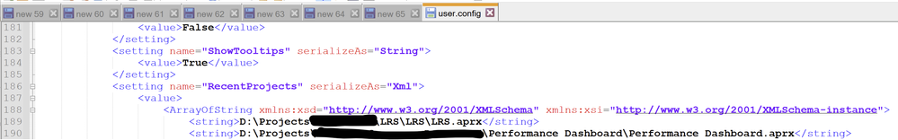

Robert_LeClair
Esri Esteemed Contributor
@PhilLampe - best thing to do is to open the user.config file on the the old laptop, search for "RecentProjects" in the file and copy the data in the <ArrayofString> area and paste that into the same area of the new laptop.  That way, you're NOT copying the entire contents of the user.config file from the old laptop to the new laptop.
