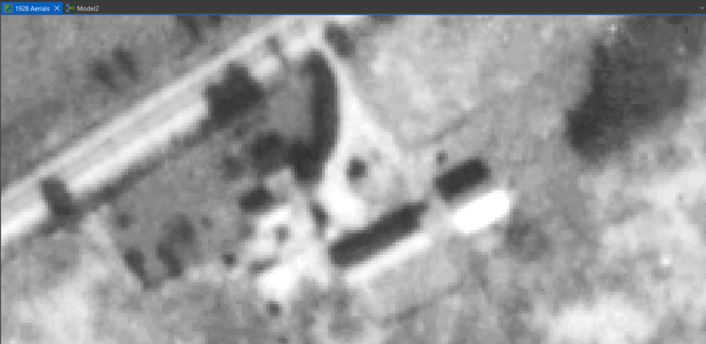

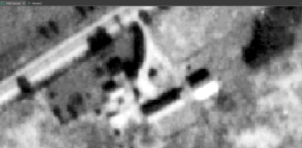

As part of a georeferencing workflow, I run the Clip Raster tool to remove non-image edge regions. However when I run the tool, the resulting image is resampled and has a different cell value histogram. I am less concerned about the histogram change - I will be color balancing in a mosaic dataset later on - but I want to understand why the cells appear to be resampled.
Input RasterInput RasterOutput RasterOutput Raster

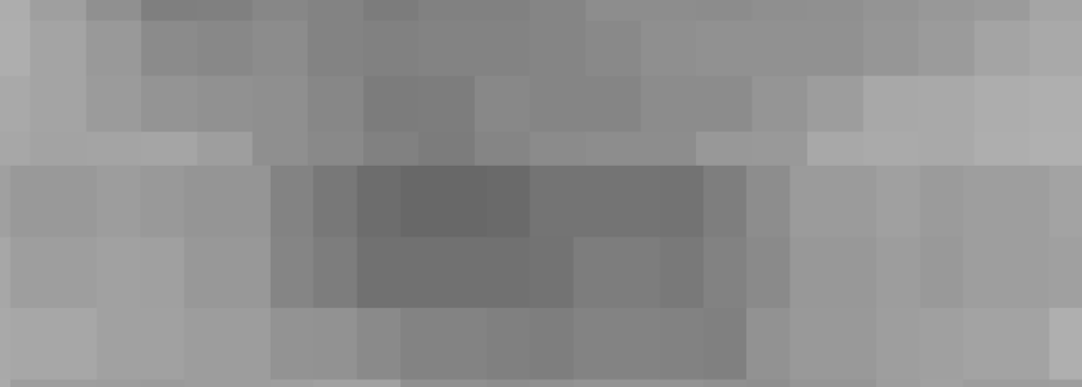

Both the size and shape of the cells in the image appear to change. When I check the cell size in the raster Properties, it states that the cells are the same size - but the Clipped image has a visibly coarser resolution that persists when the image is georeferenced and saved.
Juxtaposition of input (top) and output (bottom) along Clip boundaryJuxtaposition of input (top) and output (bottom) along Clip boundary
I run the Clip Raster geoprocessing tool with a drawn polygon as the output extent, "Use Input Features for Clipping Geometry" checked, and the default values for No Data and Maintain Clipping Extent (256 and Unchecked, respectively). I have tried setting the Input Raster as the Snap Raster but this doesn't appear to help.
