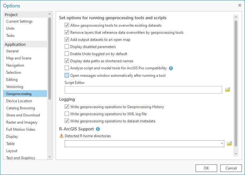

So this warning message that "by default, tools are not allowed to overwrite existing output datasets with the same name" according to the Tool Reference sheet.  What you can do is go to the Project->Options and in the Application group, click Geoprocessing.  Then check the box for "Allow geoprocessing tools to overwrite existing datasets" - see image below:
