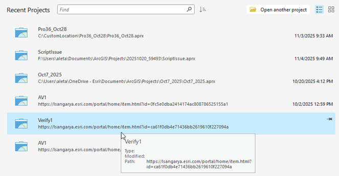

Thank you for your post.  Currently ArcGIS Pro does not have the functionality to record the modification time for individual maps and layouts.  What you saw (in your screen capture above) is in fact a bug – there should not be empty fields in the pop-up - and is already in our list of bugs to fix. This bug is not specific for maps and layouts, for example, the pop-up for the projects in the Recent Projects list can also have this problem:

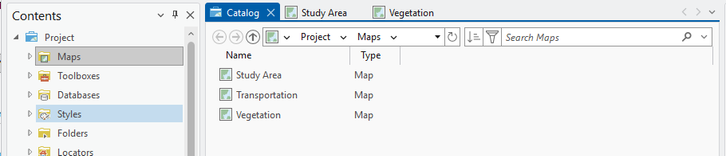

The definitive way of knowing whether a particular item type can have the modified date property is to look at the items of this type in the Catalog view.  You can see that for maps (and layouts), there are only the Name and Type columns (below), whereas if you browse into a folder or a file geodatabase, you will see more columns for the items at that location including the Date Modified column.
