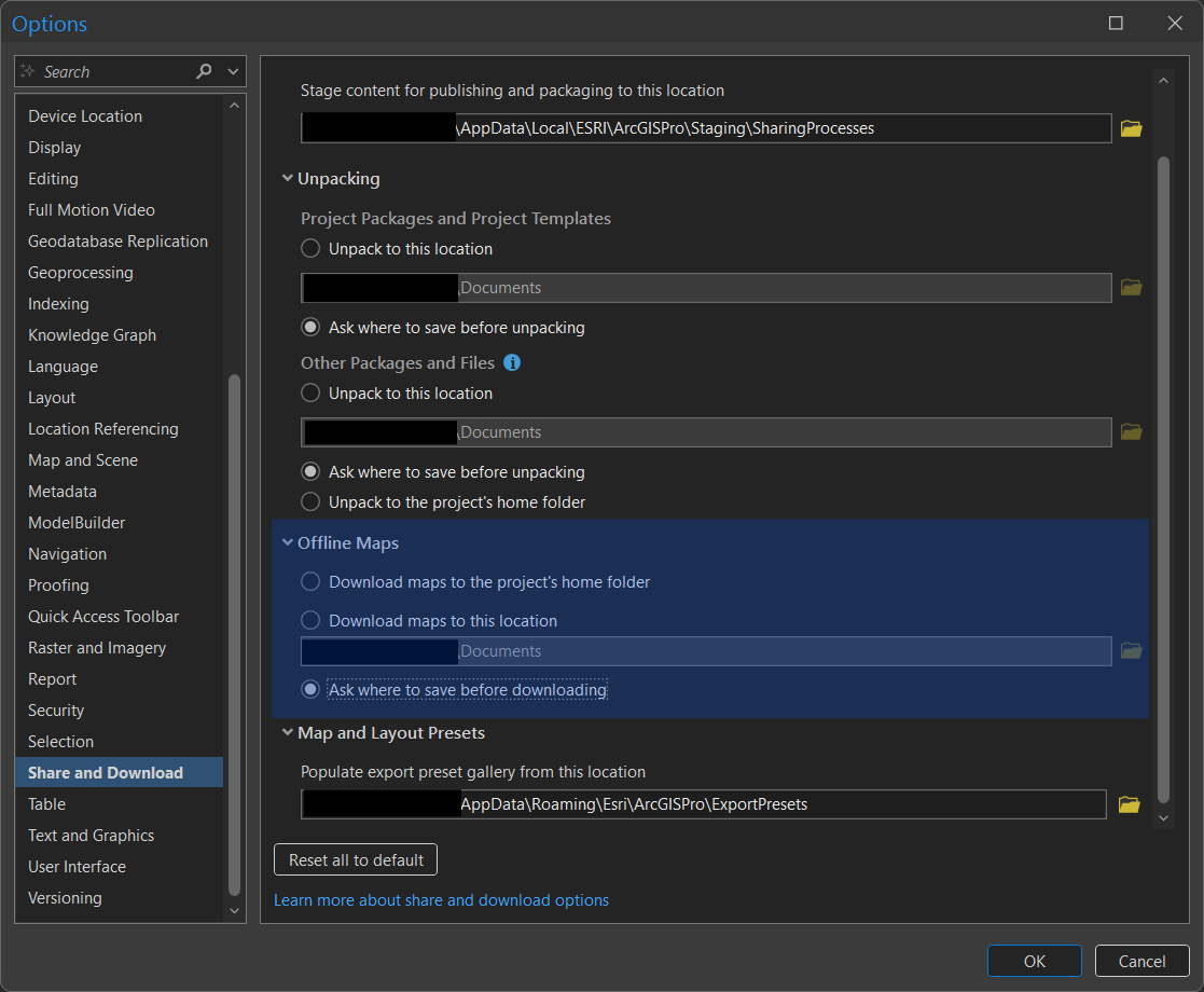

cweir
@rcGIS - In the "Share and Download" settings tab in Pro you can set it to ask you where to save output offline maps (see image).
I'm trying to export the ESRI "Streets" basemap ... so nothing custom here.

@cweir, unfortunately, I can't reproduce your issue. Following your suggestion, I changed the ArcGIS Pro settings to now be able to choose a custom directory before the map download (thanks for the tip).
I have chosen the 'Downloads' folder and I have been able to export my World Street Map basemap area of choice; see below.
