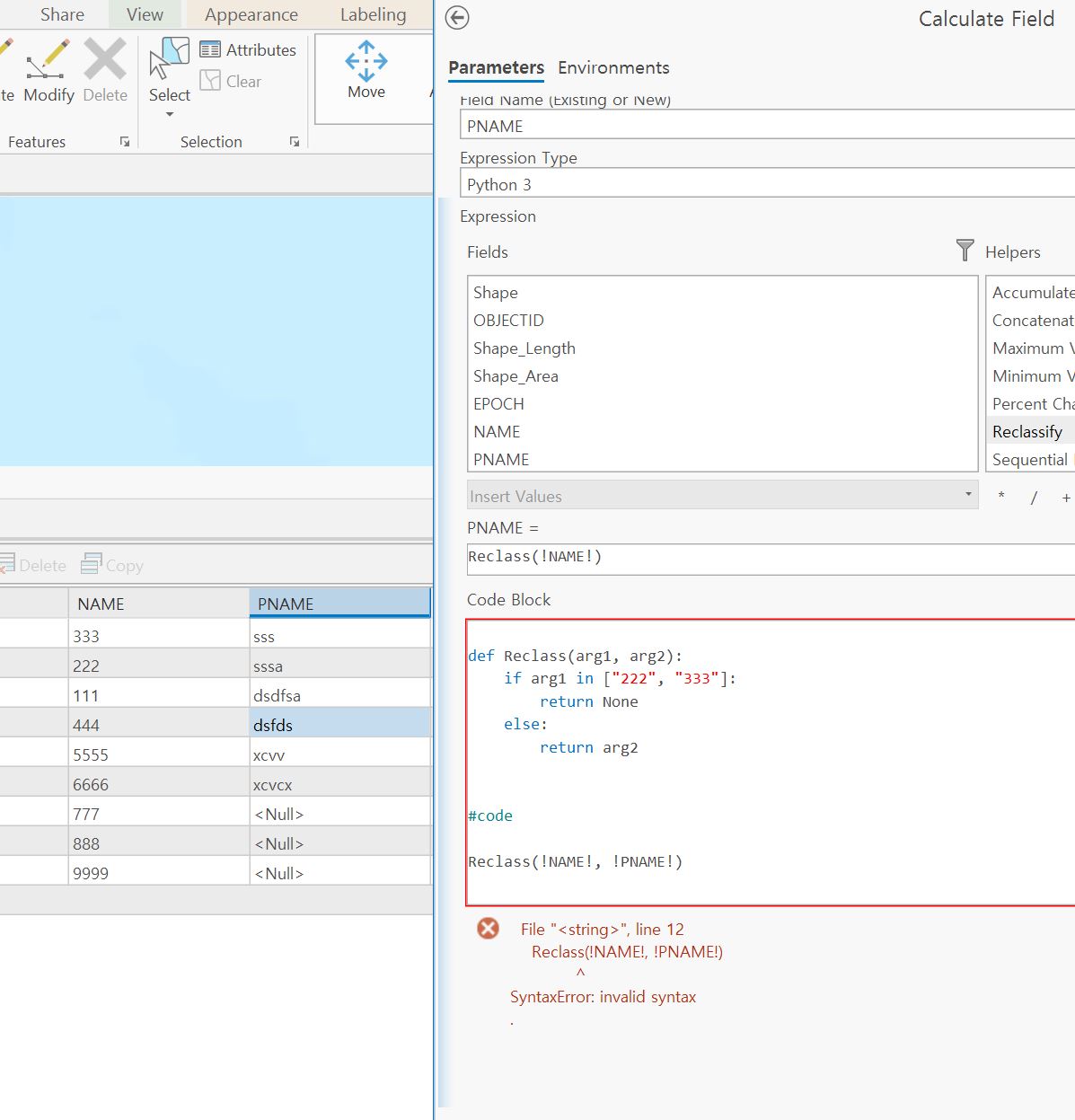

Hi~~
def Reclass(arg1, arg2):
    if arg1 in ["222", "333"]:
        return None
    else:
        return arg2
#code
Reclass(!NAME!, !PNAME!)
Please see why there is an error.

#1  You have !PNAME! as one of the parameters and you are trying to calculate the PNAME field..  You can't use the PNAME field to calculate itself
#2  Assuming that you have to calculate values into the PNAME field and you need values from 2 fields, you didn't pass in two arguments to the script in the Pname section the expression line
# 3  AND you need to remove the
#code
Reclass(!Name!, !Pname!)
in the Code block section.  Those lines are not supposed to be included in the code block.
I think you just copied and pasted an example and put some of the wrong things in the wrong place

KalSsin
I haven't figured out where the right place is yet.
I'll do a little more research.
It's a little difficult.
Thank you for your reply.
