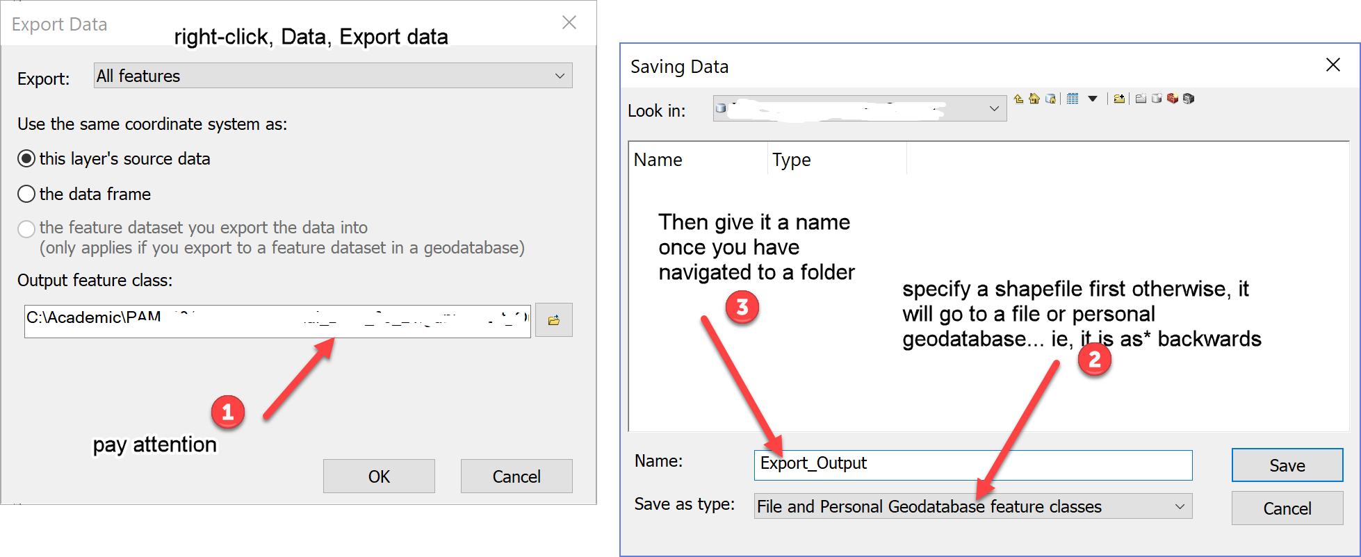

make sure everything is in the same coordinate system/projection and to be safe, convert the event layer to a featureclass or shapefile
LarsHakanson
Deactivated User
Do I convert the event layer before or after adding it to the map? I have tried converting it afterwards, but I cannot find the resulting .shp file.
DanPatterson_Retired
MVP Emeritus
add the event layer as usual, right-click on the event layer in the table of contents, select Data, Export data... specify that you want to save to a shapefile at the bottom of that dialog (the dialog is as*-backwards) you need to specify the type first as a shapefile, otherwise it gets saved to your default geodatabase, which I take you have no clue where it is.  Once you specify that you want a shapefile, navigate to an appropriate folder, and give it an appropriate name... success is in the air if the *.shp is appended to the file name that you are trying to save.

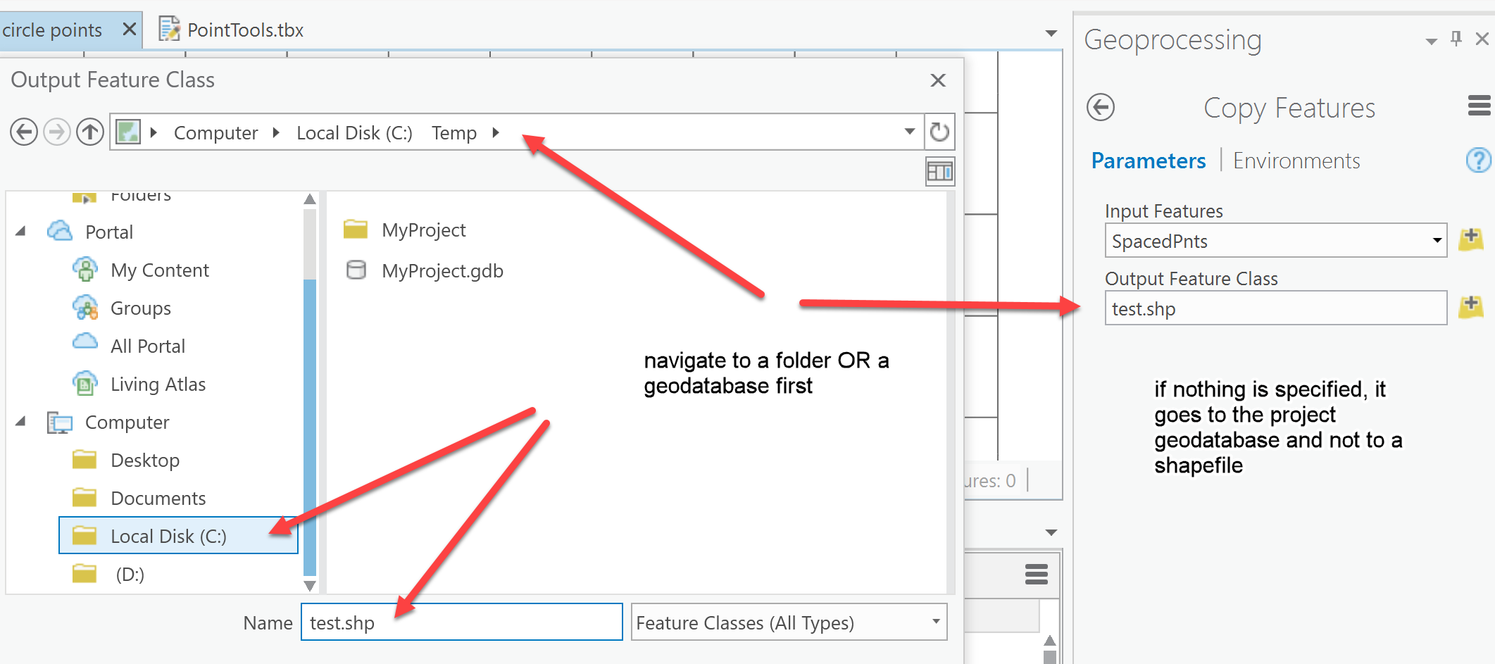

I am missing something. When I right click Data, I get the options Export features or Export table. When I click one of these, the program goes to geoprocessing directly. What does “as*-backwards” in your message refer to?
MVP Emeritus
In Pro, it just uses copy features... but choose your saving location, then the filename, otherwise, it goes in the form it wants where it wants
recent versions of arcmap, from the data frame table of contents.
