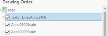

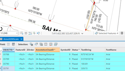

This problem may be larger then first reported.  I ran the following interactively.  I have a feature class (displayed as a layer) in a local geodatabase (Taxlot_linesAnno0200) and a branched version service layer called Anno0200Scale.
I attempted to append the features (4) in Taxlot_linesAnno2400 to a branched version Layer (Anno0200Scale).
When finished the 4 features do NOT appear in my Anno020)Scale feature class.  However the DO appear in the attribute table.
If I double click on the row in the table THEN it will appear on the map.  In addition if I leave the project and re-open the project then all features will appear normally.   I am hoping we have something setup incorrectly in how I am referencing this version or if it is a bug it gets fixed soon.  I will be reporting this as a bug today.
