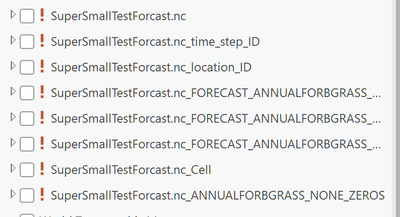

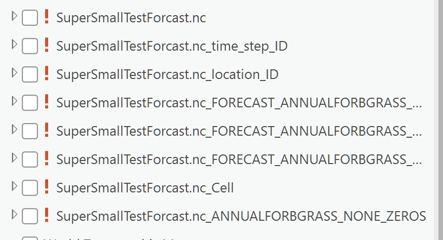

This has been happening for months now and its driving me nuts.  Every single time I shut down Pro and reopen all my NetCDF file paths break.  Nothing has moved.
Pro 3.3.1 and 3.1 so far.

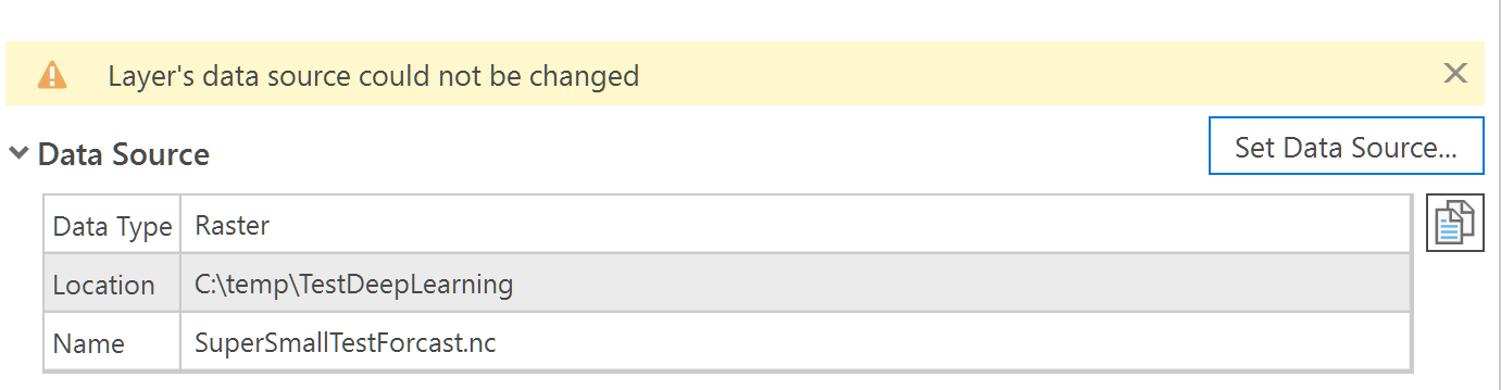

Plus if you try to change the data source I get this.

Hello @DougBrowning  , it's not uncommon for C:\TEMP folder access to be restricted by Security Policies. Does the problem still occur if you use an alternative folder ?
DougBrowning
MVP Esteemed Contributor
I do not think so - c:\temp is one of the few I can use.  Been using it on that computer for over 4 years with no issue.  Does it on 2 different computers from multiple locations.  No other files in c:\temp have issues.
Any other ideas?
thanks
ChrisUnderwood
Can you post a small sample NetCDF file for us to try ?
DougBrowning
It has done it on dozens of files as I have been making lots of time cubes.  The time cube ones do seen to have the most trouble but could be that is what I use most.  I have not found a pattern yet but it seems to take a reboot or more than one day for it to happen.  So if I add, save, close, open its ok.  If I come back in the next day, or a few days later, it breaks.  CRF files never a problem.
