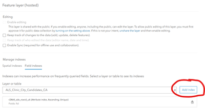

For hosted feature services you can add an index on the item's Setting page.

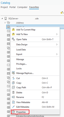

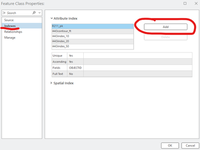

For SDE layers you can add an index from the Catalog pane through a database connection that uses an account that has permission to add an index. Expand the database connection in the Catalog pane, find your layer, right click properties, select the Indexes tab, and add an index on the join field.
