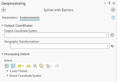

In the Spline with Barriers GP tool, if you click the Environments tab at the top of the tool, you can set the Extent parameter based upon another layer, a graphic polygon and more to limit the processing extent of the output raster dataset.
