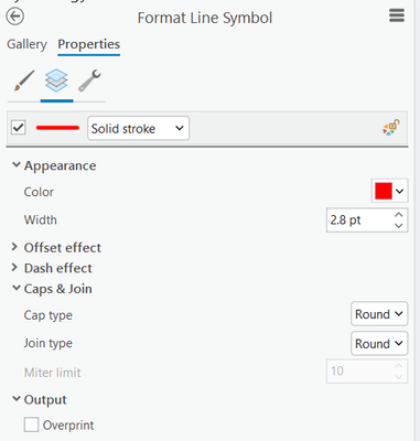

I think @Scott_Harris  might be on to something with regards to the symbology.  A simple line has these cartographic settings, do you have anything else turned on?
As he suggested, try adding the layers directly from their geodatabase into a new map and see how the editing behaves then? Don't simply copy the layer into a new blank map as you'll be inheriting the symbology, you want to try this with default symbology to nail down the issue.
