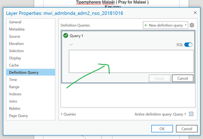

MichaelFalk
Hello,
I have been reading "A page query is a dynamic SQL where the clause is based on the values of the designated page name field for the map series. Therefore, layers being defined must contain an attribute and appropriate values that can be matched to the designated page name field of the map series index layer."
What I am wondering is where this dynamic SQL code can be found, or how it is written. My theory is, that maybe it could be tweaked to point to a different attribute and used in the standard SQL query section? Instead of using the page query tool?  Maybe?
