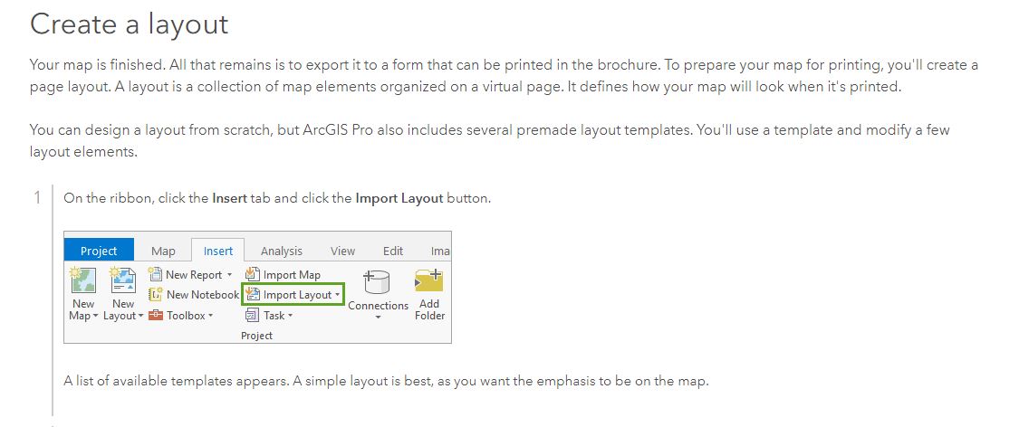

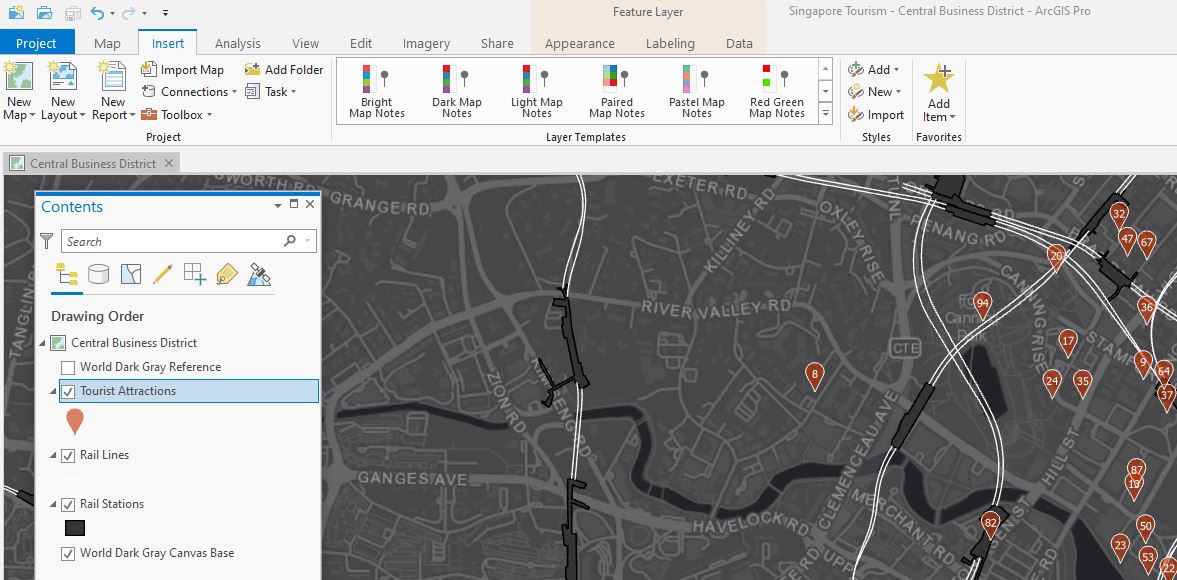

I study the applucation according to the lesson : Get started with ArcGIS Pro - Create a map to help tourists in Singapore find places of interest. On the section "Create Layout" i am directed to click the import layout' in the insert tab/ The problem: This symbole does not appear in the insert tab/ Actualy the Insert tab does not kook  as it looks on the lesson.

I also faced this problem. Right click on the ribbon and choose customize the ribbon. On the choose commands from dropdown select All Commands. Search for Import Layout. Add it to the insert menu.
