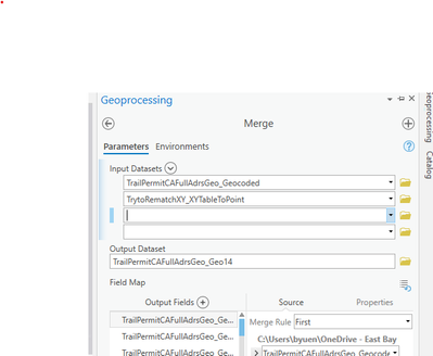

I'm new to this. I am trying to merge two layers of points to one. I went to Analysis > Tools > General > Merge. I entered the two datasets and hit "run." It generated a "merged" later in the content. However, upon checking, I can only see one dataset. I checked by selecting Appearance > Symbology > Unique Value and see that only the values for one set were included in the layer. I'm clueless as to what's wrong because I've done merge in the other project and didn't have the same issue.

Here it is. Thanks for your help.

Can you try to add the two layers in the opposite order? Does is then bring only the other layer's data?
Some screenshots from the tool's settings would be helpful!

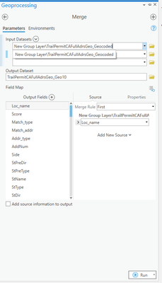

I did try to add the two layers in the opposite order and it always brings only the other layer's data. Below is the screenshot of the merge tool I used.
I had to geocode one set with full addresses and the other set with coordinates and that's why I had two layers.

What is the second dataset?
What is the full path to the output data set?

C:\Users\byuen\OneDrive - East Bay Company\Documents\ArcGIS\Projects\MyProject5-2000_Trail_Permits - Copy\MyProject5-2000_Trail_Permits.gdb\TrailPermitCAFullAdrsGeo_Geo14

you are asking for problems with those paths.  They contain spaces, and punctuation (excluding _ , which is ok).
They also don't all look like featureclasses.  If you have event layers or other data types, make them featureclasses.  That is what merge works with.
