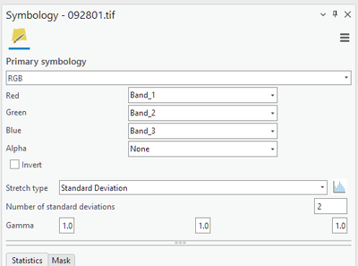

It almost looks like the symbology is messed up.  Are you actually using an Alpha layer?
Below is what mine shows by default when I add tiff to map.
I can get some weird results like that if I set an Alpha lyer.
