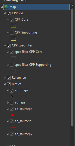

It will apply the definition query on some of the layers, but not others and seems inconsistent for which layers the definition query is applied. Here's a screen clip of the layers in my Pro project:
Anyone have any ideas for why this is happening, but didn't seem to be an issue in the past?
This looks related to the issue here: https://community.esri.com/t5/python-questions/the-attribute-name-is-not-supported-on-an-instance/td... but these layers do support definition queries (either manually or in the past when it worked through Python).
The layers are from feature services. I'm currently using Pro 2.9.5 and also tested in 2.9.0. We are currently dealing with another bug that is prohibiting us from upgrading to 3.0.
