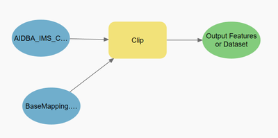

This sounds something unusual. Did you add all required inputs to get an output which your are looking for?
Because if you are missing any input feature, the tool itself and the output will be shown greyed out. For example if I am using ModelBuilder for clip tool and I only add one input and the tool it will show me something like this
JigishaAshokbhaiPardeshi_0-1718372331305.pngJigishaAshokbhaiPardeshi_0-1718372331305.png
Once I add clip feature it should be good to run the tool and get desired output. And it wont be grey any more.
JigishaAshokbhaiPardeshi_1-1718372414987.pngJigishaAshokbhaiPardeshi_1-1718372414987.png
