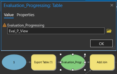

In ArcGIS Pro 3.3.1 ModelBuilder, the first time a model is run it operates correctly.
After the first run, in several tools (but not all) the names of the output tables are altered (_View is appended at the end).

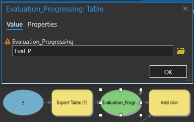

For example, this Export Table uses an AGOL layer as source and outputs the table to a local file geodatabase (path present but not shown):
After the first run, with no user interaction, output is altered as following (path is lost):

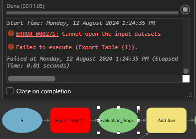

Running the model in this altered state results in Error 000271 (cannot open the input datasets):
To have a functional model again, it is necessary to edit all the output table names that have been altered, removing the "_View".
Export Table and Table Select both exhibit this unwanted behaviour, but the cause seems to be the following Add Join tool. Using Join Field or Join Features instead of Add Join might be a workaround.
