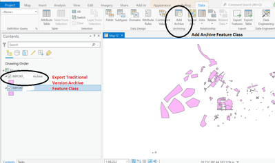

We are doing below steps :
1. ArcGIS Pro, export the existing traditional version feature class archive data into GDB.
2. Create a new enterprise geodatabase, enable branch version.
3. Import the exported data into branch enabled feature dataset.

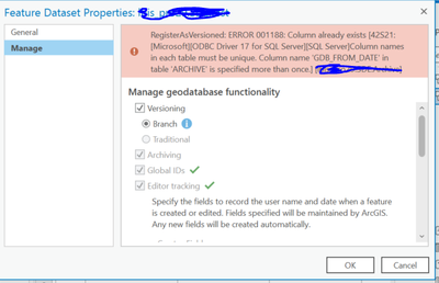

4. After importing, mange geodatabase functionality throwing the error.
