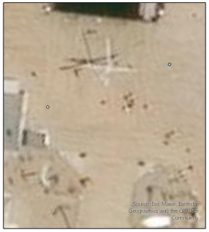

I am creating a map series where each map contains a different point in the layer- some of the points are quite close to each other so I want to show only the point I am highlighting on each map. Like in the image below I would like it to show just the pink point not also the blue one. Another post I saw suggested clicking 'Clip to index feature' but this option is greyed out for me.

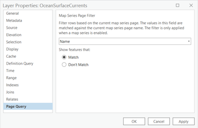

Hi! Clip to index feature is not available for a point index feature, because you can't clip a 2D map frame to a 1D point. However, there is a way to get the result you want!
A page query should do the trick.
For any layer in a map series you can have a page query. This will let you show only the features that match or don't match the map series page name. For your case, you can set the page query on your points to match the map series page name and then only one point will show.

AubriKinghorn

edward33
This is great thanks! I didn't understand the page queries before, but you explained it so well
