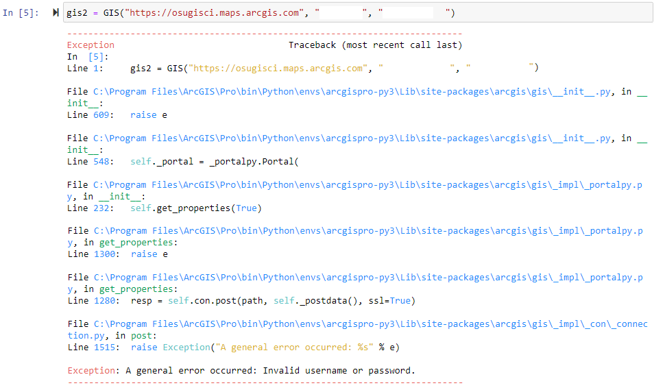

How do I login to my organizational portal?  I used the same credentials I always use, but the portal does not recognize me.  Am I using the wrong url, or is there some extra parameters needed for organizational login?
Attempting to login to organizational portal (https://osugisci.maps.arcgis.com/home/index.html) within the Arcgis Pro 3.2.  I followed the 'Accessing Data in a Portal Using ArcGIS API for Python' tutorial at Esri's training website, although they only have tutorial for Pro 3.0 and Pro 3.1.  I am using python in the notebook:

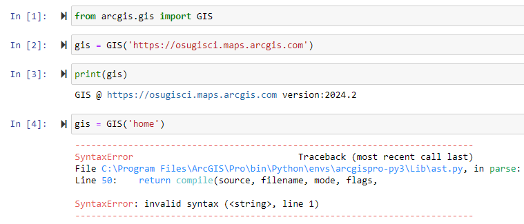

Can you try this and report on what it shows you? This is connecting to your org as an anonymous user:
from arcgis.gis import GIS
gis = GIS('https://osugisci.maps.arcgis.com')
print(gis)
Here's what I see:
In other words, it's not a problem with connecting to the organizational AGOL, it's literally what the error message is showing you, a problem with your credentials.

KevinPreston
here's my output.  To rephrase my process: I'm logged in to the arcgis pro 3.2 application (remotely via school's Citrix application), then I start the notebook from within the arcgis pro 3.2, then using the same credentials used to access the arcgis pro 3.2, I login to 'GIS' via python-notebook, but the authentication process is seen as invalid.

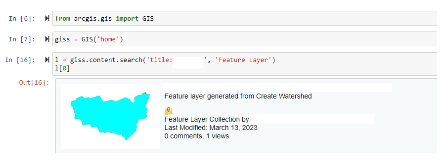

KevinPreston
It seems to be working.  I restarted a new notebook without attempting to login via the notebook.  As you allude to, it seems that something already detects I'm logged in via Arcgis pro 3.2:
