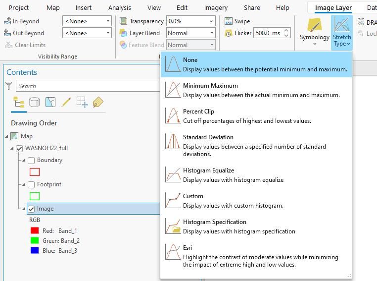

I've had this happen before and it could be that no image stretch has been applied to the raster. Select your TIF in the table of contents and then click on the Image Layer ribbon area and select a stretch type to see if that changes what you see.
MelissaGearman
This worked for me. My TIFF had a stretch type on it but it was still showing up black. When I changed the stretch type to None, it became visible.
