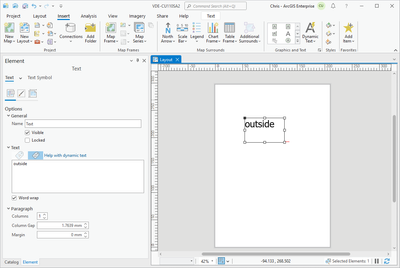

Hello @mzhang  , the text "outside" seems to work OK in a very basic test Layout. Are you using any particular layout sizes,  text strings, fonts, placements, rotations etc etc
