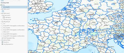

Blue= Gaul2 Layer, Black = Gaul1LayerBlue= Gaul2 Layer, Black = Gaul1Layer
Thank you for the reply! I hope this screenshot helps. Some information is only stored in Gaul1 and some only in Gaul2.

@Pia thank you for sharing additional info, so are you trying to join the attributes of gaul 1 and gaul 2? If so then the `Spatial Join` tool can help you with that but if you want to join them and get a layer that shows their respective geometries as well then may be use the `Union` tool.

Did you try one of the overlay tools as suggested?
If you want to include the geometry as well, try union
If you want to include the attributes only, then spatial join

I did, thank you! Union might be the tool for me as I don't want to loose any information and want to keep the smallest possible polygon. But the result is 5 columns in my new dataset called "deseases" (That's what I want to map). Is there a way how I can join those columns and still keep all the information? Because if I do it with Spatial Join I have to decide on what level I want to map....

You need to carefully read the documentation for Union to select the tool parameters to get the attributes as you want them
Union (Analysis)—ArcGIS Pro | Documentation
The images in
How Union works—ArcGIS Pro | Documentation
will help
Also, once your output is derived, you can always add a new field and use appropriate field calculations to combine the what you need into a single column.
