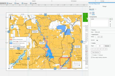

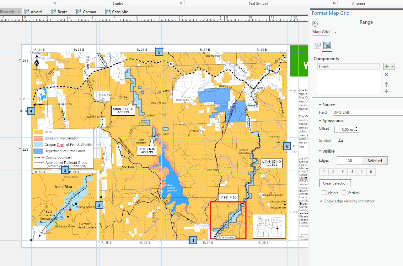

Hello,
Was hoping to get some tips on how to make the custom grid actually usable. Right now it works incredibly inconsistently
  1. I'll click to activate or turn a side vertical and nothing happens.
    1. Sometimes the check box will reflect the change sometimes it wont.
  2. Sometimes it will switch over and then the changes will just be lost and it'll revert back
  3. Sometimes changes are saved and sometimes they aren't
It is so incredibly frustrating that this just doesn't seem to work with any level of consistency. It also freaks out when I select the feature it should be using and getting the field names.
How does anyone get this thing to work?
Here is a screenshot you can see where I have the range disabled, but it doesn't do away! Like what else is that suppose to do?
