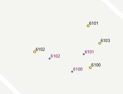

See the attached screenshot - the yellow points are our data (IDs= 6100, 6101, 6102, 6103), and the blue points are the vendor's data (IDs= 6100, 6101, 6102).
So is there a way to replace only 6100, 6101, 6102 and keep 6103 as is?
I can't use spatial proximity because their points often have different locations than the original points, and there are other close signs. (e.g. ID= 6101)

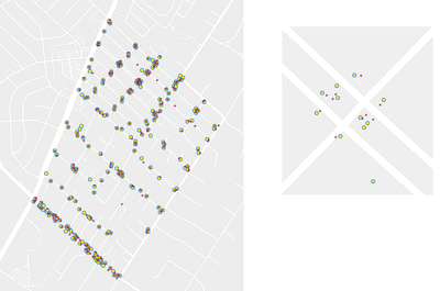

I know they updated the signs because they worked in a specific area, and this is what they were supposed to do.  The yellow points in the attached screenshots are ours, and the purple dots are the vendor's.
The screenshot in the original message was an example, to help explaining the problem.
This is the first part of a project that will include thousands of signs. so I can't sort the signs manually.

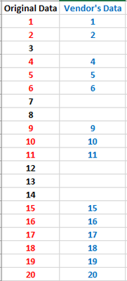

So let's say the original layer has 100 records, with unique IDs ranging from 1-100. The vendor’s data uses the same Unique_IDs but contains only 70 records. I want to replace the corresponding records from the original layer with these 70 records, and keep the other 30 records, but I don’t have a way to know which Signs were updated and which weren’t.
The table below represents both datasets. In the original data I need to replace only the records in red, and leave the ones in black untouched.

Based on that, it sounds like if the feature is in the Vendor data, then it HAS been updated and you want to replace the Main dataset features with these...
In your pic above, it appears as if that is what you are showing.  If it is in the vendors data, you have it displayed as red to delete.
So, when you establish the join, un-check the "Keep All Target Features" box, and you will only get a list of the matching features (red in above), then you can select all of them, and delete.
In your example above, if you were to right click on the Vendor's Data column and sort descending, it will move the matching rows to the top, you can select any that have value in Vendors data column and delete.
Or, put definition query where Vendor's data is not null will show only matching features, and then select/delete.
Several ways to do the same thing.
Whichever method, after the delete, just copy/paste or append the vendor data back in.
