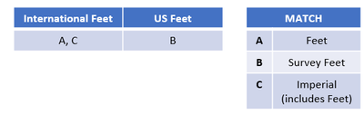

There seems to be several terms used to describe measurements in units of feet.
Is the "matching" chart below correct with respect to Int'l vs. U.S.?
"Imperial is the one that confuses me the most, because i read that the U.S. is the only country still using it. If so, why do we also have US Feet?
Thanks,

The following table should help:
International footUS survey foot
Imperial footUS foot
FootSurvey foot
Note that, ArcGIS Pro didn’t differentiate between the two distinct foot definitions previously and this was updated in ArcGIS Pro 3.0.
As in the NOAA publication referenced:
"U.S. survey foot is retired and replaced by international foot."
"From this point forward, surveyors will refer to the international foot as simply the foot."

The difference between International and US Survey Feet is that the international foot is defined as 0.3048 meters, whereas the US survey foot is 1200/3937 meters (or 0.30480061). However, earlier this year Congress retired the US survey foot as a unit of measure.
I hope this helps, Andrew.

@Craig_Eissler_Iceman Great question! Looks like you have screenshots from ArcGIS documentation - always helpful if you include the reference link.
Anyway, if your focus is Feet, there are just two:
1 International foot = 0.3048 meters
1 US survey foot = 0.3048006096 meters
The two federal agencies, National Institute of Standards and Technology (NIST) and National Oceanic and Atmospheric Administration (NOAA) retired use of the “U.S. survey foot” on December 31, 2022.
Reference: https://www.noaa.gov/stories/thinking-on-our-feet-december-31-marks-end-of-us-survey-foot
US survey units are based on imperial units (British) and sometimes used interchangeably. As noted above there may be a slight difference between specific US survey units and its corresponding imperial units.
Reference: https://pro.arcgis.com/en/pro-app/latest/help/editing/distance-formats-for-editing.htm

And, there are not just 2 "terms", there are 5 -- and I am attempting to associate them with the 2 you mention. ...All of the terms below are used in ArcGIS, so it's confusing which are synonymous.
International Foot
US Foot
(AND)
Feet
Survey Feet
Imperial
