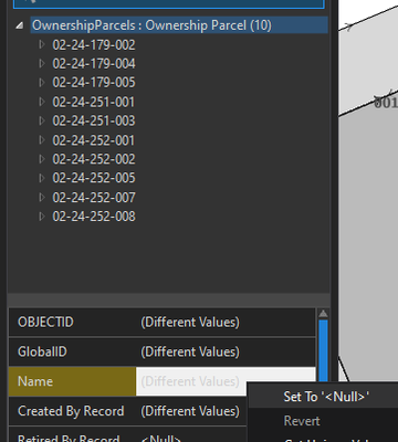

With so few values, it probably wouldn't be too terrible to manually fix it. Fill your blank fields in Excel with a value like "zzz".
Once your table is imported, you can use Select by Attributes to select all of those features, then set the attribute to Null from the Attributes pane.

Yes, find and replace in Excel should work for getting the "placeholder" in, and then the rest of the process as described in Pro would take care of the rest. It sounds like a limitation in the Excel to Table tool, honestly. There are better ways to get tabular data into Pro if this is something you're going to do regularly. Exporting your table to a CSV, for instance, will include the empty values in a way that is correctly interpreted when the CSV is opened in Pro.
