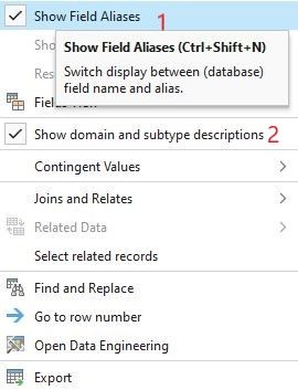

If a feature class has an alias, and I add that feature class to a map, Pro uses the alias as the layer name in the Contents pane automatically.
  • Is there a way to toggle the Contents pane to show for each layer its table name instead of its alias name?
I'm looking for something equivalent to the Show Field Aliases and Show domain and subtype descriptions toggles that we have for attribute tables:

You're welcome!  With regards to your follow up question, please see the image below first:
In the Table Options, it seems #1 and #2 are already part of the ArcGIS Pro options to switch between Field Names/Aliases or Subtype and Domain Values and descriptions already.  #3 is the previously mentioned ENH request.  One way to get feedback on the ENH status is to call Esri Support Services and add your Customer Number to the ENH request.

I think there are two outstanding issues that need ideas/enhancements.
Scope
Per the screenshot above, we can currently toggle two types of aliases: field, and subtype/domain.
The issue is that we have to do this on a per-table basis. I routinely work with geodatabases with hundreds of registered tables, which makes for a lot of clicks to disable all those aliases.
