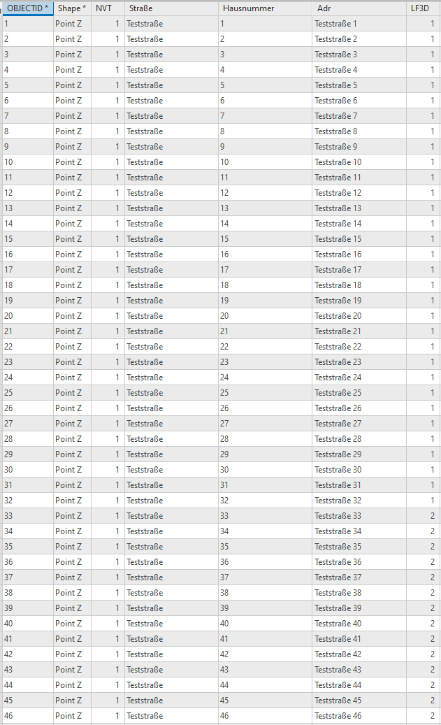

Tahnks for trying to help Dan! I know what you mean but that doesn't fit my purpose. In my case the array/field is different. For example:
array([1, 1, 1, 1, 1, 1, 1, 1, 1, 1, 1, 1, 1, 1, 1, 1, 1, 1, 1, 2, 2, 2, 2, 2, 2, 2, 2, 2, 2, 2, 2, 2,....])
so for the first 32  times  1 in the array it shall return 1 in a new column for each one. for the next 32 times 1 it shall return 2.
So if the array has 90 times a 1 it shall return in a new column for the first 32: "1" for the next 32:  "2" and for the remaining 26: "3"
If you have an idea let me know. I definetly have to improve in this area 🙂
Kind regards Fynn

FynnScharpen
Thats the problem. NVT can have numbers between 1 and 100, has to be sorted and its frequency of each varies. Hausnummer is only sequential in this test case normally it isn't.
Not sure if you understood my problem. My technical English needs to improve.
1. Step: Sorting all addresses based on NVT
2. Step: Count the number of addresses that have the same NVT number.
3. Step: The first 32 addresses with the same NVT number get a 1 in LF3D if there are more than 32 the next 32 get the 2 in LF3D and so on.
4. Step: Repeating step 3 for the next NVT number
