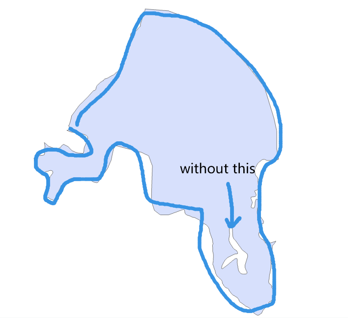

I want to create outmost outline of this kindlike polygon not include inside island's outline. How can i reach this goal.

why not use ArcToolbox tools...
Eliminate Polygon Part (Data Management)—ArcGIS Pro | Documentation
will do the job without having to edit each one

It's an easy job. Create the outer polygon and the make it transparent going to the symbol ogo tab. Create the inner polygon where you want the lake like feature. Select the inner polygon and use clip geoprocessing tool. There will be option to remove the touching polygon area. Or else delete both the inner polygon and the clip created.

Maybe there's a problem with my expression,there is only one feature in my picture. So once i choose, i choose it all, i can't choose the outer polygon.So called inner polygon is empty, i can't choose it.

Use the tool in the Screenshot. Setting also to be followed
YLZ
Thank you sir, i cant choose the inner polygon, so i cant use the clip tool.I've used eliminate polygon tool. Still thank you for your help.
